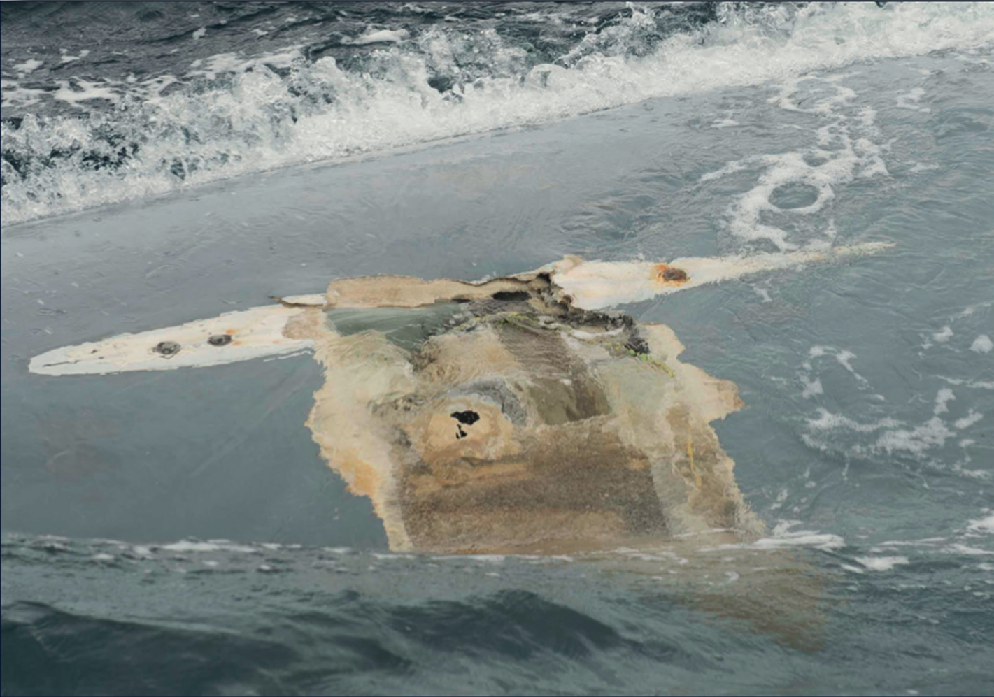

Everyone should read the annexures to the Cheeki Rafiti report. It is the annexures that contain the scary information on how to repair a hull after groundings.
The investigators questioned leading repairers of keels after groundings and found that they all had different methods of investigation and solutions. Cheeki Rafiti had been repaired after one grounding.
I would insist on a number of repairers advising on the issue and, if possible, someone from Bavaria.
Re: Bavaria keel damage
« Reply #14 on: February 19 2017, 11:18 »
You need to remember that the construction method on the First is very different from the Bavaria in question as the grid is bonded in rather than solidly laminated.
This is relatively new, which is partly why there is not a consensus as to how to repair them. Indeed one of the recommendations of the report is that designers, builders and repairers carry out further work on how best to repair them.
This is not the case with Bavaria keel support structures (and many other makes of similar vintage and design) where there are well accepted ways of repair. However it seems that the repairers here are not following the correct procedures which at the least require cutting back far further than seems to be the case from the photos.

I agree with Symphony that the keel attachment on Bavaria yachts seem better than the system used by other manufacturers. I've seem a couple of Oceanis 473s with the grid pulled completely from the hull. The hulls in these cases were not glassed to the grid, merely glued.
My main reason for comment is that it is the repairers that, sometimes,  don't know what they are doing. Also, given the large number of fibreglass repairers and the ( hopefully) few major groundings, I don't believe there is a vast deal of experience out there in repairing keels after major groundings.
In the Cheeki Rafiti report, the design was shown to be good, it was the previous damage that was the likely cause. It does seem that Bavaria do over -engineer the keel hull joins but this will not protect from a severe grounding.
Bavaria should be keen to assist but there appears no way Bavaria is to blame in this case.
