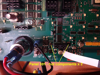

More importantly, I had worse hot-spots on a previous panel just before it failed, leaving me without any DC power! I'll try and attach a pic below, showing the specific hot components. If your panel is almost too hot to touch in the same areas, I suspect you have an incipient failure on your hands as well.
I was in NZ at the time and tried, unsuccessfully to have it repaired. I was quoted NZ$1,220 plus GST for a new one by the Bavaria NZ agent, Christine Bird at Busfiield Marine, and EUR 610 plus freight by Bavaria Service in Germany. Happily I was able to buy a second-hand panel for a fraction of that.
Good luck!

Was on the vessel recently and checked the panel, it seems to be the large heat sinks.

I think it is the heat sinks.
I'll continue to monitor the problem and see if the problem gets worse.
