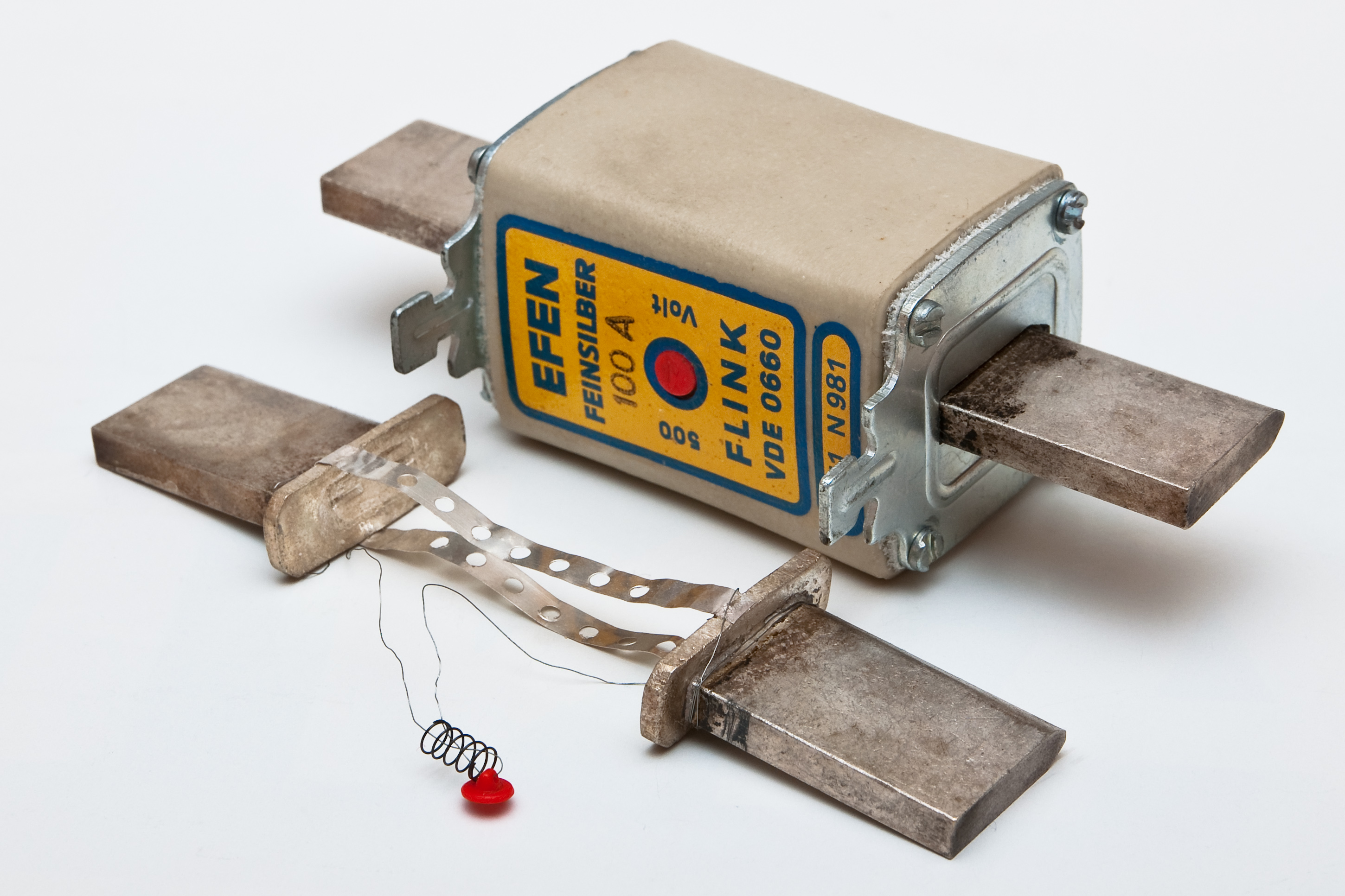

The fuse you depicted is not resettable. It's a NH blade type. When it triggers, the red indicator dot pops off and you have to replace it. I carry a few spares, which are widely available from industrial suppliers. Never needed to replace one yet. Searching for NH fuse <rating> should find you plenty of sources.
