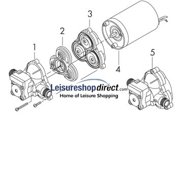

The Shurflo/Aqua King/Flojet pumps have a non-return valve that holds the pressure when the pump is idle. This may have a miniscule leak (often caused by debris) where some water flows back through the pump, thus slowly losing pressure back into the tank. Unlike a leaky hose, this isn't noticeable because there's no puddles. The aforementioned pumps are easy to disassemble and clean, so may be worth checking.
The valve is just a membrane, the center one labeled 2 here: http://www.leisureshopdirect.com/product_images/shurflo_lge.jpg
